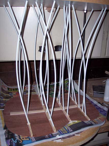

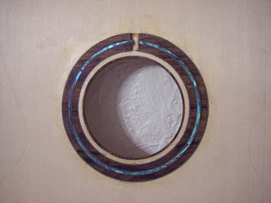

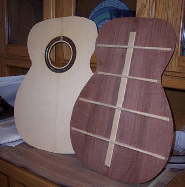

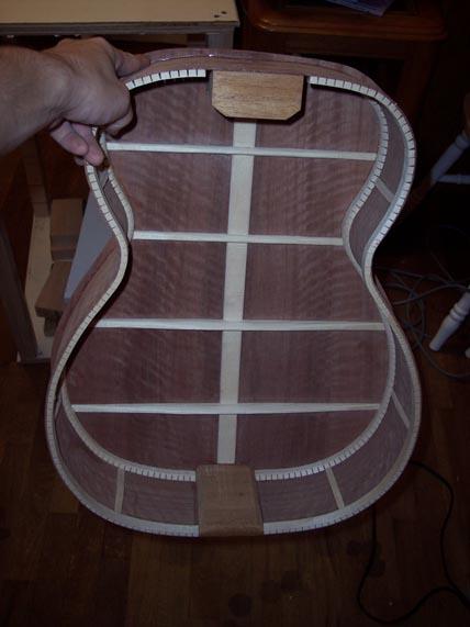

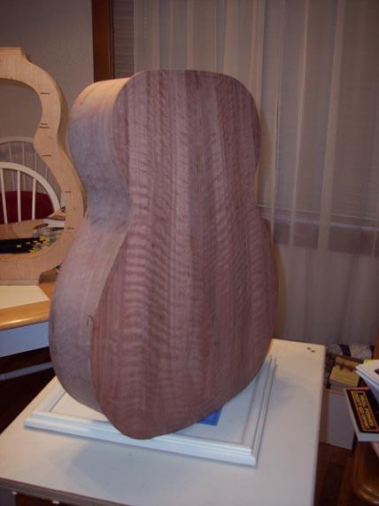

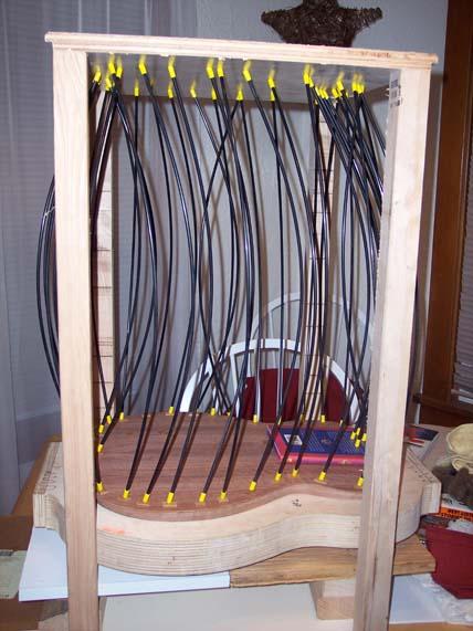

OK, here is my progress to date. It's more like 4.5 or 5 months... but this is what I've done in my spare time. I am intentionally keeping any close up shots far away from all of you!
That's it as of last night! Need to trim the excess off the back and get that top on now!! It's starting to feel a bit more like a guitar and less like an ugly, expensive birdhouse.
Christian
PostPosted: Thu Aug 23, 2007 3:02 am
I'm with Todd, looks great to me. I've finished my second and your rosette is already better than what I've tried. The boat looks terrific, and is neat as it can be.

[QUOTE=Hesh1956] When my first had the back on but not the top I called it a litter box........ [/QUOTE]
No cats would be safe in Tacoma if such desecration ever occurred.
